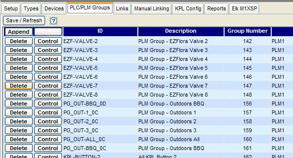

I am now trying to get them going, and I have the opossite problem of Judetf - Valve 1 via PH.Insteon works OK.
Valve 2 - via PH.InsteonGroupCU crashes the program, and sometimes PH. The code all looks OK.
I am suspecting something other than the code.
What is everyone setting their EZFlora devices as? I only have a choice of "31270 - EZRain irrigaton controller", which I am using.
Thanks in advance,
Richard

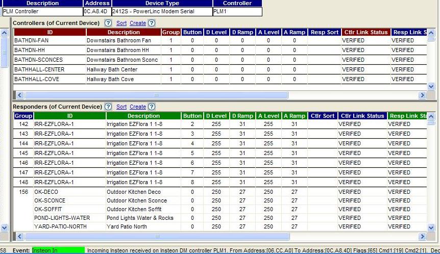

You have a separate PLC/PLM Group for each valve you are trying to control? Does the link to valve 2 show Verified Verified? Does the Insteon Raw Log show any Insteon traffic when the ph.insteongroupcu to valve 2 is executed?
RichardL Senior Member
Joined: December 29 2008 Location: United States
Online Status: Offline Posts: 165
Posted: June 08 2010 at 01:13 | IP Logged
Hey Lee long time no speak, hope all is well.
Yes I have PLM group 142 for valve 2 (EZF-Valve-2), 143 for 3, thru 148 for valve 8. Only one of the two EZFloras I have are linked to the group. I am waiting to finish troubleshooting before adding the second. The address of the active one is 05.92.39.
Yes everything is verified.
I attached some snapshots, including the 3 raw log entries that resulted from the run.
I am also getting a script error, but I see no syntax problems.
I am testing in the code a section that will simply turn off all valves via a for/next loop. If the counter is 1 then I do a PH.Insteon - which seems to be OK, when the counter goes to 2 and I do a PH.InsteonGroupCU then the code stops. Sometimes it kills PH.
Thank you!
Posted: June 08 2010 at 01:56 | IP Logged
The RUN ERROR looks like a problem with the VB script. That message does not say much. I don't do much VB script but what I remember it was hard to debug because so little was provided when there was a problem.
You did not detail the ph.insteon command but it sounds like you are using an Insteon Direct command to control valve 1 and Insteon Group commands to control valves 2-8. The responder link record data for LD1/LD2/LD3 is different for an EZFlora. For an Insteon Group command to control a valve, the responder link record LDx data looks like....
LD1(bright level)=0 LD2(ramp rate)=0 LD3(unit number)=x
where x is the valve number (relative to zero) to be controlled by the Group. That is, x would be a 3 to control valve 4. The LD3 unit numbers range from 0-7 to control valves 1-8.
You might find it easier to control all the valves with Insteon Direct commands. That way you don’t have to manage links at all. Can you post the ph.insteon command you are using to control valve 1.
