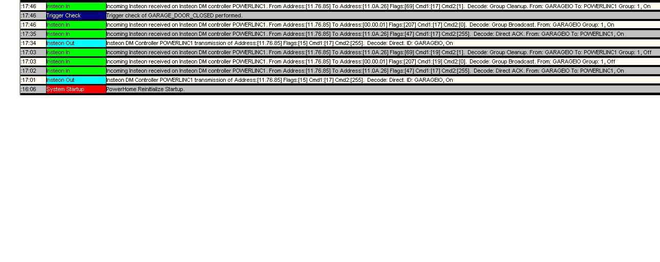

Hey guys,
   I've setup PH with the IO Linc GArage door controller and for seome reason, only an "ON" command will open and close the Garage from the controller.  As I understand it, an "ON" should open and "OFF" should close or vice versa depending on config.  Below are the status entries when a manual command is sent to open then close the garage.  Any ideas???

The IOLinc output relay Normally Open circuit is normally wired in parallel with the garage door open/close manual push button.  You push the manual button, closing the button circuit, and the garage door opens.  You push the manual button, closing the button circuit again, and the garage door closes.  Not all but most garage door manual buttons are Normally Open buttons.   The circuit is closed when the button is pressed.
 When you energize the IOLinc relay with an ON command, you close the IOLinc relay Normally Open circuit and the door opens.  The IOLinc relay has a built in timer that turns off the relay in a few seconds.  The next time the IOLinc relay Normally Open circuit is closed with another ON command, the door is closed. Just like the manual button.

I think the IOLinc is operating in the Momentary A mode.  The following descriptions were taken from the User Manual.
 Momentary A
 Either an On or an Off can be programmed to trigger I/O Linc's relay. The other command will be ignored. For example, if an On command is programmed to trigger the relay, an Off command will be ignored.
 There are two other momentary modes available with the IOLinc.
 Momentary B
 Send either an On or an Off to trigger I/O Linc's relay. I/O Linc's relay will respond to both.
 Momentary C
 Use I/O Linc's sensor input to determine whether I/O Linc's relay will trigger. An On command's desired sensor state can be programmed to either open or closed. I/O Linc will use the opposite for the Off command's desired sensor state. For example, if an On command is programmed to trigger only when the sensor is closed, an Off command will trigger only when the sensor is open.
 You can setup the IOLinc relay to operate in whatever mode you prefer.  In all three cases the IOLinc relay is operating in some form a Momentary operation.  The relay energizes using the rules associated with the specific mode selected, A, B or C, and deenergizes after the programmed delay (default 2 seconds).
