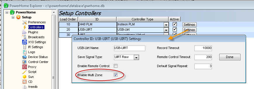

You are correct in that "Enable Mullti Zone" must be checked in the PH Explorer Setup control device Settings window.

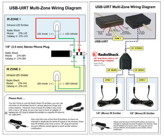

The 1/8" (stereo) jack on the back of the UIRT allows remote IR transmitters to be attached. For Zone-2 use, wire a stereo plug Tip(+) and Shield(-) {Left Channel} to your remote IR sender, and Ring(+) and Shield(-) for Zone-1 {Right Channel}. Alternatively use a stereo to mono splitter.

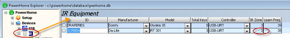

See the inserted picture. Since you can set up IR devices (where each device you set up has a ZONE that it is associated with), do you still need to construct IR sequences with embeded zone information in them?

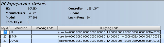

PH does indeed take care of all the Zone control if the "Enable Multi Zone" box is checked in the Controller Setup for the USB-UIRT . . .
Then in the Devices>IR Equipment screen just enter the IR Zone value in that field.
NOTE: If Multi Zone control is NOT enabled then the rear output jack on the UIRT box does not function. All IR commands are assumed to be for the built-in blasters on the UIRT box and nothing is echoed to the rear jack.
If Multi Zone control IS enabled then the IR device signal commands are ONLY sent to the specific IR port designated for the IR device in the IR Equipment window.
IR Channels are designated as follows:
CHAN# Signaling Means
1 External rear jack ring/sleeve (Right channel)
2 External rear jack tip/sleeve (Left channel)
3 Internal Front Blasters
NOTE: There are no special Zoning designators required in the Outgoing Code fields. Only the standard <pronto> code sequences.

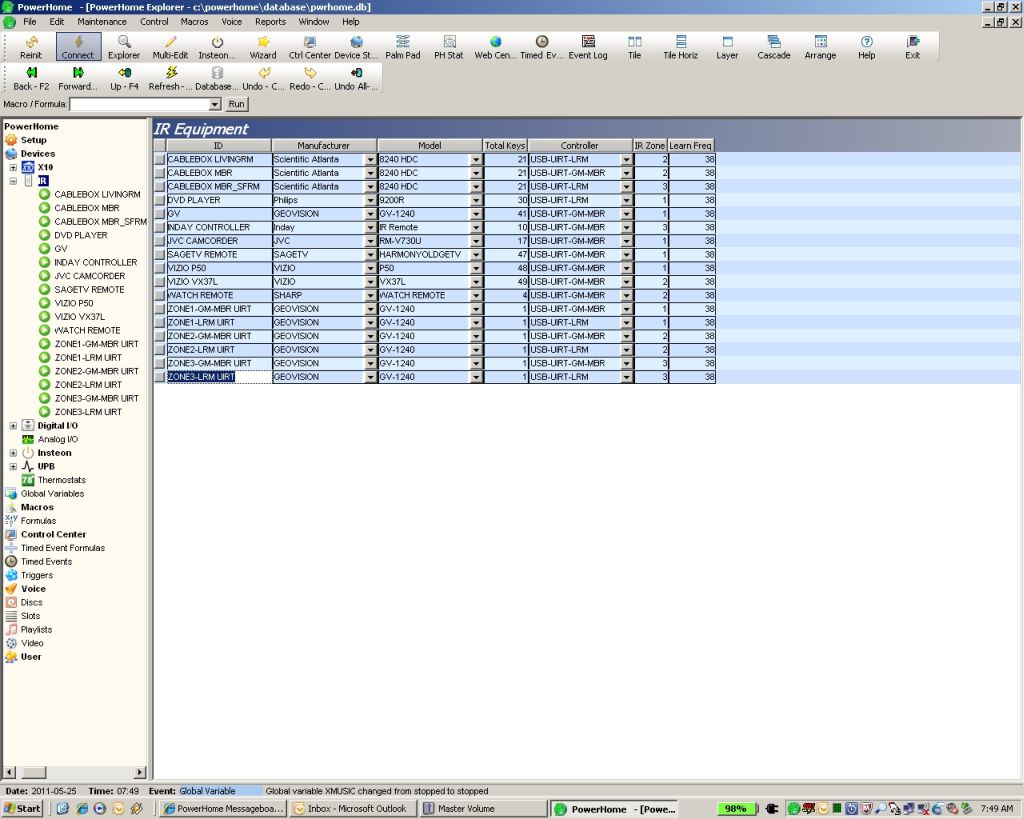

A number of programs that support the USB-UIRT allow for Zone 1,2, and 3 support AND an "All" zone designator.
Is this possible in PH when multi-zoning is enabled? If so how?
Or does one just have to fire off multiple sequences when the same IR command needs to be sent to all zones?
| Posted: May 25 2011 at 22:54 | IP Logged
PowerHome handles all of the Zone related details internally and no mods such as adding the Z and zone number should be added.
Once multi-zone is enabled, the zone number for an entire devices IR codes is set in the "IR Equipment" screen under "IR Zone". You can override this at the individual IR code level by using the <zone> tag within the code (multi-zone MUST still be enabled...without enabling multi-zone, you will not get any zone control and the IR will be sent to ALL zones). The use of this tag will look like:
<pronto>0000 0071 0000 0048 0080 003F 0010 0010 0010 0030 ...<repeat>2<zone>3
In the example above, the type of IR code tag (<pronto>) comes first, followed by the <repeat> override followed by the <zone> override.
If multi-zone is enabled, you can send to ALL zones (just as if multi-zone was not enabled) by using a zone outside the range of 1 to 3 so you should be able to set the zone to 0 in either the IR Equipment screen or in the <zone> override.
