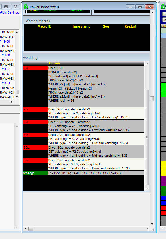

Quote:
       | Dave said -  ... settings concerning the Status window would all be set from within the PowerHome Status window. With the Status window open, double-click on the display area of any of the mini status windows and this will toggle the titles being displayed or not. With titles displayed, you can drag and rearrange the mini windows or resize them as you like. |
 Dave I tried playing around with resizing the panes but as soon as I escaped from that exercise by selecting Window>PowerHome Status (the only way I could find to escape from the resizing effort) The left side of the Event Log Title text got trimmed away, and I can't get it back, ever after a Re-Initialization.
 The horizontal scroll bar control at the pane bottom is all the way to the left.

 Double clicking on the detail area of any of the sub windows will toggle titles on and off. You can only resize/move with titles on.
 The main PowerHome Status window has horizontal and vertical scrollbars. This main window is a container for all the sub windows (eventlog, time info, execution queue, etc). The eventlog sub window also has vertical and horizontal scrollbars. In your screenshot, the horizontal scrollbar is for the main PH Status window. The horizontal scrollbar for the eventlog window is below out of sight. Use the vertical scrollbar on the main window to scroll down until you see it then resize the eventlog window until its no longer offscreen. When you're done resizing/moving, you can turn titles off by double clicking (if you so desire...I prefer the extra real estate, others may like the titles). Once you've got the screen the way you like, closing it will save the settings as will right-clicking and selecting "Save".

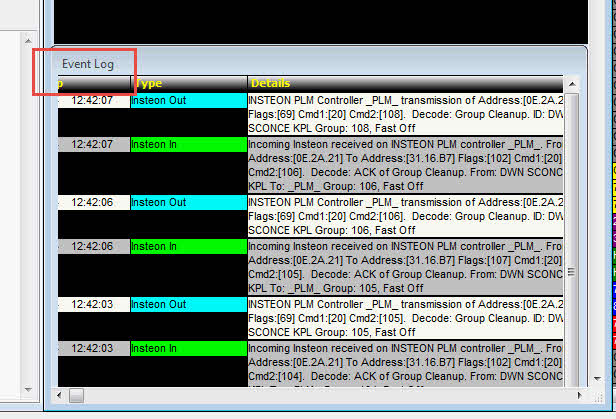

Quote:
       | The horizontal scrollbar for the eventlog window is below out of sight. Use the vertical scrollbar on the main window to scroll down until you see it then resize the eventlog window until its no longer offscreen. |
 Good thinking Dave, however been there done that and there is no eventlog horizontal bar to work with.
 That's why I reported the issue.

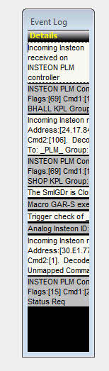

Interesting.  If you double-click on the PowerHome Status window title bar and open up the Pane/Frame handling, the Event Log window clearly NEVER shows a horizontal scroll bar, even when you squeeze the pane down to 1" wide !!
 But. I think that is a benefit {as IBM would say, a "Feature"}.  :-)
 By decreasing the width of the Event Pane I was able to trim off the date info (which isn't very useful in the real-time presentation showing things that are happening in real-time [and thus obviously today])
 I kinda like this bug!!   [:-)}
 I vote for "NO FIX" as it makes the Event Log pane much more useful!

Ken, why am I not experiencing your problem? If I right click and hit load on the PH status window I can resize with no problem. I leave by hitting save. My Event Log can be narrowed way down and I don't lose the scroll bar. Or am I misunderstanding what the problem is??

OK Ken, now I see what you are referring to. But why do you need a horizontal scroll bar if the window shows the whole line?

BeachBum wrote:
       | OK Ken, now I see what you are referring to. But why do you need a horizontal scroll bar if the window shows the whole line? |
 The window is not showing the whole line.  Most of the Title of "Time Stamp" is hidden except for the "mp"
 BUT, as I indicated I rather like it now that I think about it.  Having a real-time event log that shows the month/date/year plus the time seems a little out of whack.  Generally real-time data comes from 'right now' so for 99.9999998% of the time the month/day/year is unnecessary.
 By trimming it down to just the time, there is more room for valuable data presentation, which I rather like.
