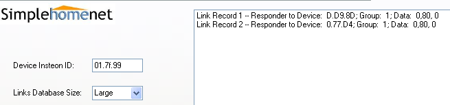

  Joined: June 01 2008 Location: United States
           | Posted: December 02 2009 at 20:48 | IP Logged
Ah, Ha!  Progress.
 When I dumped the EZIO40 high mem I got a totally different result than the prior low mem dumps.  Can there really be two different entry areas?  The dump is. . .
 where 0D.D9.8D is the PLM; and 00.77.D4 is the ControlLinc

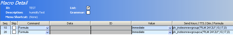

 Re: the macro being updated.  Yes it was, but to be sure I just ran it again with the same results (no rawCU entry).  BUT THAT SAID I did notice a 0.1 sec red flash in the ph status bar when I executed a macro (normally meaning a bad command).
 Could I have done something wrong in line 20 below?

  Joined: March 26 2008 Location: United States
           | Posted: December 02 2009 at 21:10 | IP Logged
The Large option is reading from 3FF8 memory location.  The Small option is reading from 0FF8 memory location. The 3FF8 location is where the EZIOO4 internal PLM is looking for active link records as that is where it wrote links created with the Set button .  The Mem Top column for the EZIOO4 Types entry must be changed to 16384,  Powerhome reinited, and the DB Scan column checked so powerhome will read the correct memory locations in the EZIOO4.  The reason the PLM "responder to" link record in the EZIOO4 is not working for us even though it is written in the correct active link area is the Group number is 1 and it needs to be 10 (0x0A).  That link record would have been written when you used the Set button to link the powerhome PLM to the EZIOO4 which uses Group 1 as the default.  If Powerhome is ever to read/write active link records in the EZIOO4 the Mem Top value must be fixed.  The what and why details are in one of my earlier posts so I will not repeat that here.
           | Posted: December 02 2009 at 21:18 | IP Logged
The ph_insteonrawgroupcu does not have the correct syntax.  Check the Help facility for the parameters used by that call.  The device address is required.
