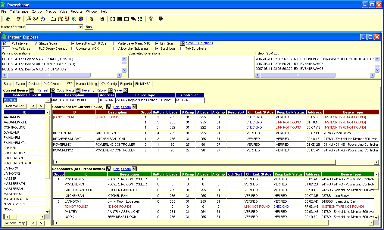

Ok guys, need a little feedback here. Below is the new Insteon Explorer Links screen at the moment:

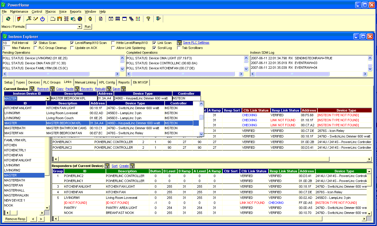

The Devices is now a single line at the top showing the currently selected device. The ID is also a dropdown which will allow you to easily jump to specific devices by typing the first few characters of the ID. It's kind of hard to picture, but here is a second screenshot with the dropdown dropped:
You can also navigate to a Current Device by double-clicking a device in the Device List, Controllers, or Responders so it should be fairly easy to navigate to whatever device whose links you want to view.
Another change is that drap and drop between the Device List and Controllers or Responders is now active. You can highlight device in the Device List and drag them to the Controllers or drag them to the Responders to add links. You can also highlight devices in either Controllers or Responders and drag them to the Device List to delete links. I think this is pretty much what everyone wanted.
My question is: With the drag and drop for add and delete links capabilities, would you like to see the 4 arrow buttons disappear? Or would you prefer for them to stay so you have a choice of the old method of highlighting and pressing a button or the new drag and drop.
Another improvement is that the delete links (using drag and drop or the left facing arrow buttons) will now intelligently perform either an actual link deletion where the links are actually deleted from the devices (what the left facing buttons in the current version does) or will just delete the links from within the PowerHome database without actually deleting from the devices (what the Remove Controller and Remove Responders buttons currently do) based upon the link status.
My second question is whether you feel that we can also get rid of the "Remove Controller" and "Remove Responder" buttons? One place where this is useful is when you just want to get rid of links and then "Rebuild" the remaining links to compress the database. With the "Remove" buttons, you can delete the links from PowerHome and then "Rebuild" and not have to wait for the links to actually be deleted from the devices.
Let me know what works for most people so I can finish up the changes to this screen.
Thanks,
