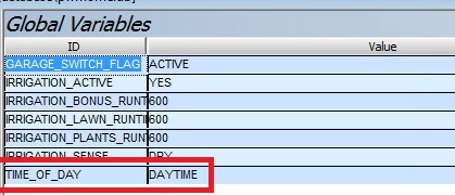

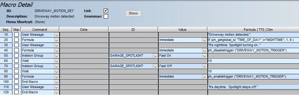

This problem has been driving me crazy for months. I have a timed event setup that toggles my "TIME_OF_DAY" variable between DAYTIME or NIGHTTIME. This works correctly. For some reason the 2nd line in the macro I show in the below will always just proceed to step 3 and turn the light on even if the variable is currently set to DAYTIME or anything else. I'm totally stumped because I copied this exact same command from my old PH system that worked fine, but it refuses to work for me now. What am I doing wrong? Thank you in advance!

In line 20, change the command from "Formula" to "Jump"

Wow, I knew it was going to be something dumb I was missing. Thank you!!
