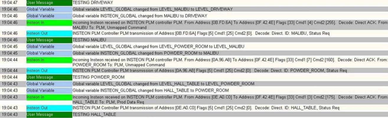

Since upgrading I am now getting these responses to a PH_GETINSTEONLEVELRT. The actual line is testing a device for a predetermined level.
IF (PH_GETINSTEONLEVELRT(PH_GETGLOBAL_S("INSTEON_GLOBAL")) = PH_GETGLOBAL_N(PH_GETGLOBAL_S("LEVEL_GLOBAL")), "NEXT", "TEST2")
In the image the test were successful but why the “Unmapped Command” and the “Prod Data Req”?
| Posted: February 08 2011 at 11:11 | IP Logged
Pete
That’s a glitch with the new code. Most commands issued in the cmd1 field have the same cmd1 value returned in the ACK. The Query command is one exception as the ACK cmd1 field has the Link Database Delta number rather than the Query command code. The variations between devices is that each device is returning the Link Database Delta number for that device. In 2.1b the Query command was not traced in the Event Log. Now that it is the code needs a tweak to label that value as Link Database Delta rather than trying to map it to a command name when it is a Query command. That is harder to do as the only way to know it is an ACK to a Query is to remember the original command since it is not in the ACK for a Query command.
Joined: April 11 2007 Location: United States
| Posted: February 08 2011 at 11:21 | IP Logged
That is probably why sometimes under 2.1b I would occasionally see the “Unmapped Command” appear.

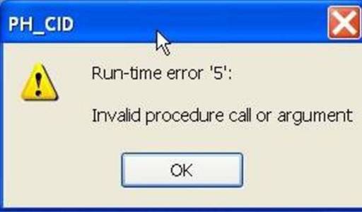

Anyone seen this since Beta with CID Plug-in?
No indication the trigger fired.
Edited by BeachBum - February 23 2011 at 11:00
| Posted: February 16 2011 at 08:41 | IP Logged
Haven't seen that error, but do seem to notice that Triggers can be MUCH slower to react to changes with this release.
Based on observations so far it almost seems like Triggers are not sensed if there is something waiting in the execution queue or there is a waiting macro (not sure which one is the culprit).
When those queues are clear my triggers seem to be immediate, but when macros are in the wait state or PH is polling devices I have seen up to 20 second delays before a Trigger will trigger.
May, or may not, have anything to do with the error you are seeing Pete, but in case it is a clue, I thought it worth noting.
| Posted: February 16 2011 at 09:05 | IP Logged
I’ve sensed the same thing but don’t have any documentation to support it unique to 214. This CID problem is intermittent and once it fails the trigger will not fire until re-init. I would think Dave has a clue what might be causing this. The plug-ins on the Help screen give no clue to a problem before of after.
