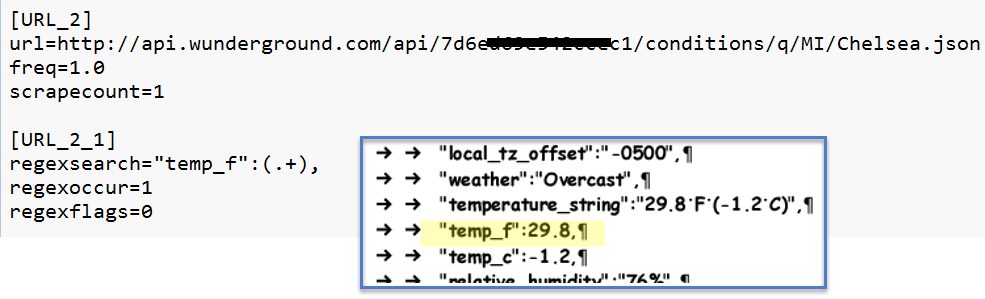

Dave - Trying to get the URLScraper to extract data using the Weather Underground API, but with no success.
To start, just trying to pull one thing (temperature) but I never get a trigger response, nor do I get a response on the Command 256 Scraper error trigger.
Not sure if I am doing something wrong or if the data returned by the API is throwing the scraper for a loop.
Here is what I have so far, with the scrape .ini on the left, and what I think the the data should look like on the lower right (highlighted in yellow).
Any ideas?
Posted: November 27 2014 at 11:42 | IP Logged
Got it solved.
The documentation was not clear and I will fix the Help file for this plugin before 2.1.5b is released.
The problem was in the way I had the Triggers set up. When the scrapecount is >1 then the trigger "Trigger ID Number" must also be adjusted to match each URL group. Since I had two URL Groups defined, I needed to use "Command 2" for trigger ID # and NOT Command 1 as I had.
I'm getting data now!
