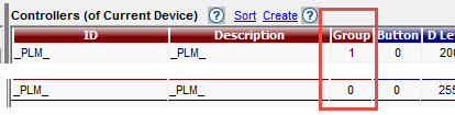

Why is it that sometimes when a new device is defined that the Link window automatically shows the PLM as a Responder by default BUT sometimes it shows the Group number as 0 and other times as 1?
Two different devices shown below...

Ken,
The PLM as a controller with a group of 0 is the link that is created by the CREATE I2CS INITIAL LINK operation for I2CS devices.

There would be no need to create a link with the PLM as a controller and a remote device as a responder unless you were going to control the remote device via that link. Direct commands will always be ACKed even if no links exist (unless its an I2CS device). More importantly is to have a link with the PLM as a responder and the remote device as a controller so the PLM is notified of manual control of the remote device (for devices that actually can be manually controlled).
Creating the initial link in an I2CS device cant be done using the normal link creation methods and instead has to be accomplished via a special dedicated command that gives you no control over the group number or the level and ramp rate. Its only purpose is to place the PLM's address in the I2CS devices database so the I2CS device will respond to the PLM for any future commands including the normal link creation. This link that HAS to exist for I2CS devices can be any link with the PLM however so after the initial I2CS link is created, you delete it as long as you have another link that already exists with the PLM. If you try to delete the initial link and create a new different PLM link in the same step, you'll end up with the initial link being re-created as soon as its deleted since PowerHome deletes links before creating new ones.
