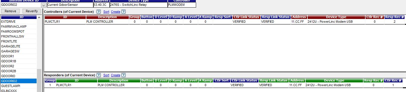

Hi Dave - many thanks for all the thorough explanations. Filling in
the blanks...
My Timeout count on the IOLinc is 0. There are no failed matches,
and it is not flagged anywhere as failed. (no special colors). I
have been doing the linking by selecting the IOLINC as current
device (not Disabled, Enable Pending checked, poll interval=3). I
click Rebuild and I can see the links pushed out successfully. (I
then click Save but nothing visible happens). So I think I'm doing
everything properly. (see example in
http://www.kwcpa.com/ph/links.JPG - it was too big to upload)
I tried something this morning - I selected the offending IOLINC
Responder link and clicked on ReVerify. After it completed I had a
correct (all VERIFIED) responder link, along with another one that
had some FLAGGED CREATE and empty fields. So I dragged the
weird link left to remove it, and now the link screen for the IOLINC
looks good with everything Verified. (
http://www.kwcpa.com/ph/postReverify.JPG )
However, when I test the IOLINC, Operation is the same as before.
I don't see any additional messages. When it's activated, I still see
2 Group Broadcasts (On or Off) and one Group Broadcast (Grp
Broadcast Success/Fail). But no cleanup messages :-(
Should I see cleanup messages? If so, what should I try next?
I'm sorry to be such a bother here.
Best
/j

Hi Dave - So I cleared and re-loaded the PLM (Add Full), manually
reset, and relinked (Rebuild) the IOLINC. The links and CtrlRec #
seem good (see attached). I set things so that after the IOLinc was
triggered, there was NO other INSTEON traffic for more than 10
seconds. In that time window I see the IOLinc send its On
message, along with it's Group Broadcast Success/Fail, and
nothing else (no cleanup messages :-( ).

Success/Fail and that message rarely doesn't show up. I also am
replacing my homemade filters on the Garage Door motors (which I
think are much of the reason the original On/Off messages don't
get through) with Filterlincs that arrive today I'm happy to try
something else if you think of something, but right now I think after
2.2 is running I should be in good shape. Thanks for all the
education and help!
/j
