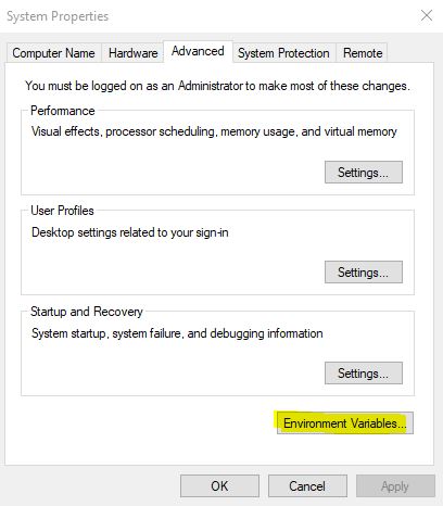

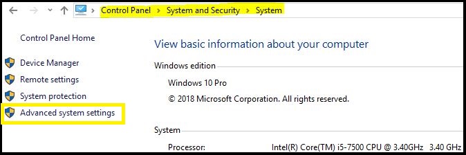

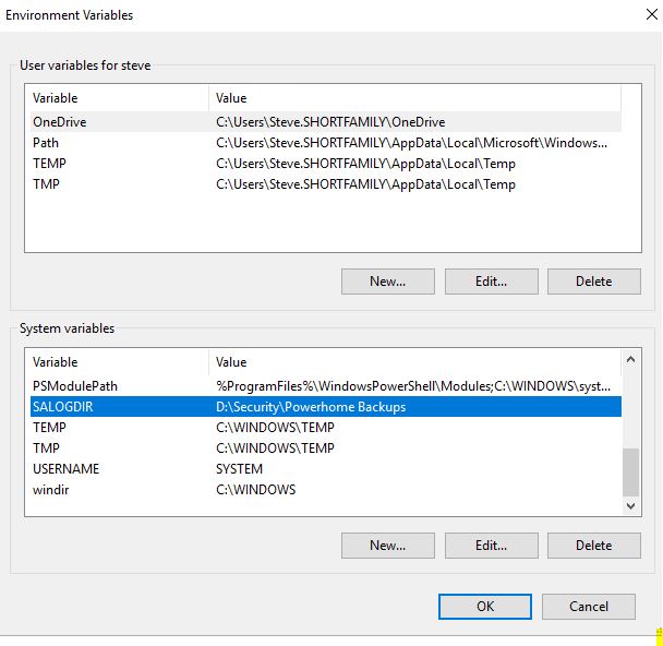

This is not really a Powerhome setting, it is a Sybase setting, what PH uses for its database. Just make sure you create the folder first, and have full
access to it before assigning the new env variable. Here are the instuctions:
Search for Control Panel from the start menu. Then in the control panel window type this into the address space:
"Control Panel\System and Security\System"
From there choose "Advanced system settings" on the left side:
Then click the "Environment Variables" button on the advanced tab,
click "New...", then assign the Variable as "SALOGDIR", and the path as the folder that you choose, preferably a new folder that you create in the
"C:\Powerhome" install folder (Mine's on a different drive where I keep all of my security data and scripts).
Then since it is a system variable, it is best to restart your system so that Sybase (and Powerhome) uses it properly. Once you do, every time the backup runs it will write to that new
folder.
