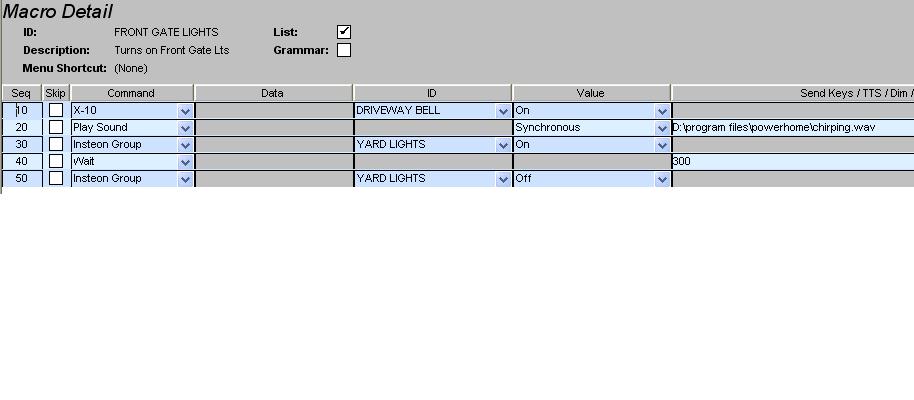

Here’s what happens: the triggerlinc signal is received, the yard lights macro is started, and the trigger is disabled and then enabled five seconds later. Only problem, the macro action happens over the next ten minutes. The X10 signal turns on exactly 5 minutes after the triggerlinc signal starts the macro. But, only the housecode is sent, and then, exactly five minutes after that, the second half of the X10 signal is sent! In the meantime, the relay unit is beeping for the five minutes! (I.e., 20:33:34 Transmission of Housecode: H, Unit Code: 16; 20:38:34 Transmission of Housecode: H, Command: ON)
One minute twenty seconds later the second triggerlinc ON signal is received, and even though the trigger has been reenabled, the trigger doesn’t fire. Then, over the next two seconds, all the yard lights turn on and any PH traffic that has taken place in the last ten minutes seems to rush in.
In other words, everything happens, but it’s like it has been in a queue waiting to execute. Yet nothing appears in PH Status that shows any waiting macros or anything in the execution queue. The debug file is below in case anyone knows anything about it.

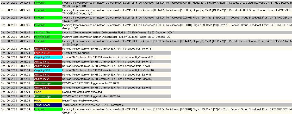

The one thing that happens that may help is the raw insteon log. As soon as the trigger fires, there is a repeated transmission: TX 02 63 DC 00
This doesn’t seem to be an address I recognize but is presumably the X10 H16 ON signal?
The raw log, with redacting for redundancy, is below

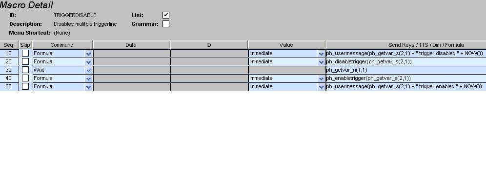

The trigger contains the following Boolean:
IF (NOW() >= RELATIVETIME( 00:00:00, [SUNRISE]) AND NOW () < RELATIVETIME (00:00:00, [DUSK]), ph_macroparm("Triggerdisable",5,0,0,0,0) + 1, IF (ph_macroparm("Triggerdisable",5,0,0,0,0) + 1 = 1, Ph_macro ("Front Gate Lights"), 0))
This basically runs the Triggerdisable macro for day and night conditions and runs the FRONT GATE LIGHTS macro for night conditions (unless I've botched it).

| Posted: December 07 2009 at 01:33 | IP Logged
Are you issuing powerline commands from within the trigger itself? I'm pretty sure Dave said that is a no no. The Raw Log shows X10 commands flooding the powerline for those 10 minutes. If issuing powerline commands from within the trigger itself, move that activity to a macro.
EDIT: just saw the trigger logic was also posted. I think the disable is okay within the Boolean field but the trigger action should invoke a macro rather than invoking a macro directly from the Boolean field.

The reason it does that is that during daylight hours a different macro is executed (Front Gate Alert - from within the ACTION field of the trigger) and during nighttime hours, the other macro is executed (Front Gate Lights - from within the Boolean). I don't really know why issuing a macro from within the Boolean would cause a flood of powerline commands, but if you have a way around it, I am all ears.

Dave said it had something to do with the task level that Boolean field processing is done at versus the task level outbound PLM communication should occur at.

Hmmm. OK. I'll think about how to rewrite it. Basically I want to run one macro with a trigger at day, and another macro for the exact same trigger at night. I suppose I could just have two triggers and one will execute and the other won't.

Dave's response was to a post you originated. Discusses moving controller commands out of the Boolean field and into the Action field.
Link to Daves answer regarding Controller commands in Boolean field

I would think the ph_macroparm would be okay since nothing in that flow results in controller plm commands.
