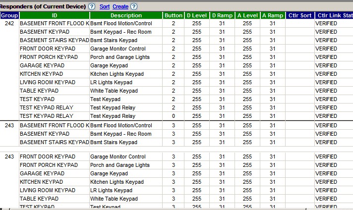

I met success with the reporting export. What threw me is that to get the export function, the report has to be run from the top menu, not the tab in Insteon Explorer. I exported to a spreadsheet, which I can sort.
Speaking of sort - no luck. Prior to, and after a PHUpg.exe, I cannot sort my data. An interesting thing is that the PLM data is in fact sorted, but KPL buttons, etc are not. The sort button does nothing.
See below button 1 of a KPL, note that this is page 1 of about 2 1/2 pages of links for this button. Very hard to manage...
If anyone has sorted their links, let us know.

Turns out some of mine are sorted and some are not. The ones I spot checked before were sorted but that may have been just the luck of the order of the link records in the device when it was discovered rather than PH actually presenting them in a sorted order. Except for the PLM I do not have the large number of links per button that you have.

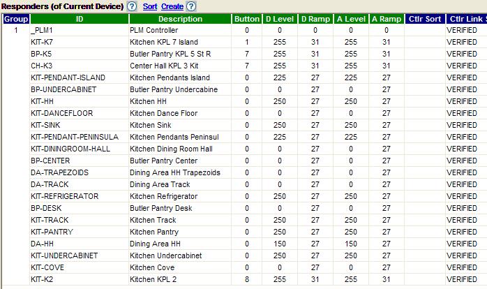

I can clarify some of the sort issues here .
The "Controllers Of" window is sorted by Group, ID, Button. Where I think most of the questions are stemming from is the sort of the "Responders" window. This window is sorted by Group,Ctlr Rec #,ID. This may seem like a very strange sort until you understand the specific problem that this sort was trying to identify. What was becoming problematic was "bad" records being read during standard database scans. Sometimes, a byte would be misread (I know, this isnt supposed to happen with Insteon, but it does) and it would appear as if a new record was read from the database. It would of course have the same record number but now there would be 2 (sometimes more) records that were conflicting with one another. This sort would be the bad record numbers all together so they could easily be spotted and cleaned up.
Looking at it though, it does present a challenge when working with alot of links within a single group. I'll work on adding a mechanism so that the user will be able to sort the links in the order they prefer. I'll do some experimenting and post back here.
Concerning the "Sort" text. That basically resorts the list to the default sort (as described above). You may ask if you cant change the sort, why do you need to resort. Its there for when you are adding links (dragging them over). When you drag devices over to create new links, the blank links come to the top. After filling out the necessary information, you can then press the "Sort" text to have the new links sorted within the list properly.
Hope this helps clear up some of the questions.

Since I can now export to a spreadsheet, I have done some sorts there, which has allowed me to take a roster and confirm my group memberships.
