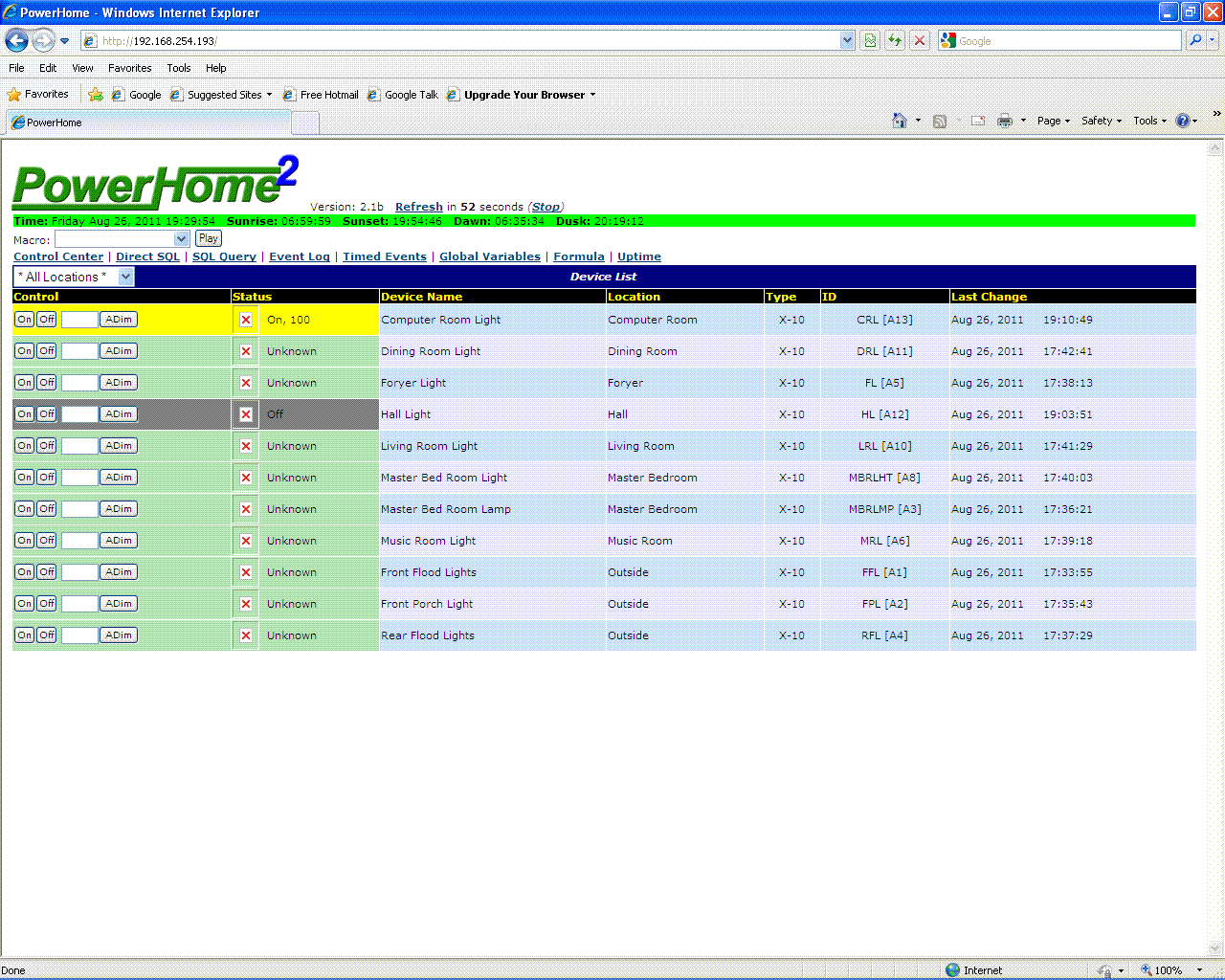

Hi Again,
 I'm just starting to play with the built-in web server and I've ran into a strange one. Most of the graphics, like the on.gif off.gif, etc. don't show nor do the graphics on the control center page when I access the web center, even though they're in the web directory. I found a post and thought it was because the path has spaces in it and fixed that but it didn't help. Now I'm wondering if the default install to the "Program Files (x86) directory under windows 7 may be involved.
 If someone can point me in the direction of a fix it'd be great.
 Thanks
 Derek

 Completely reinstalled PowerHome to c:\powerhome and set up everything from scratch but still the same thing with the web images. They don't show in the web center or when accessing from another pc on my network.
 I haven't done anything odd installing or setting up and my installation isn't very complicated. Not sure what to do now. Everything else with PowerHome I'm using works just fine.
 Derek

           | Posted: August 26 2011 at 19:54 | IP Logged
Dave,
 Just to clarify, it is the status images that don't show per the image I uploaded. The graphics under the control center are fine as well as the other pages as far as I can tell.
 Derek
           | Posted: August 26 2011 at 22:35 | IP Logged
Derek,
 In PowerHome Explorer, navigate to
 PowerHome|Devices|X10|Types.  Adjust the filepaths for the
 on, off, dim, and unknown status graphics for each type.
 This should get the status working for you.
 Let me know how it goes.

           | Posted: August 27 2011 at 04:12 | IP Logged
Dave,
 That was it. Fixed all the paths and now I'm 100% working across the board. I really appreciate your help on this.
 By the way, PowerHome is great piece of software and just what I was looking for in home automation control so a huge thanks for it too!!
