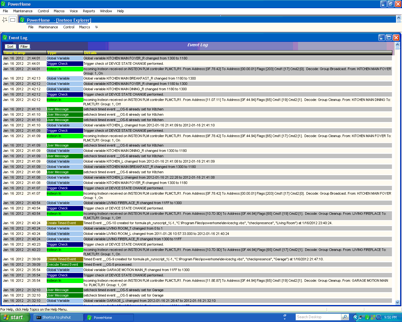

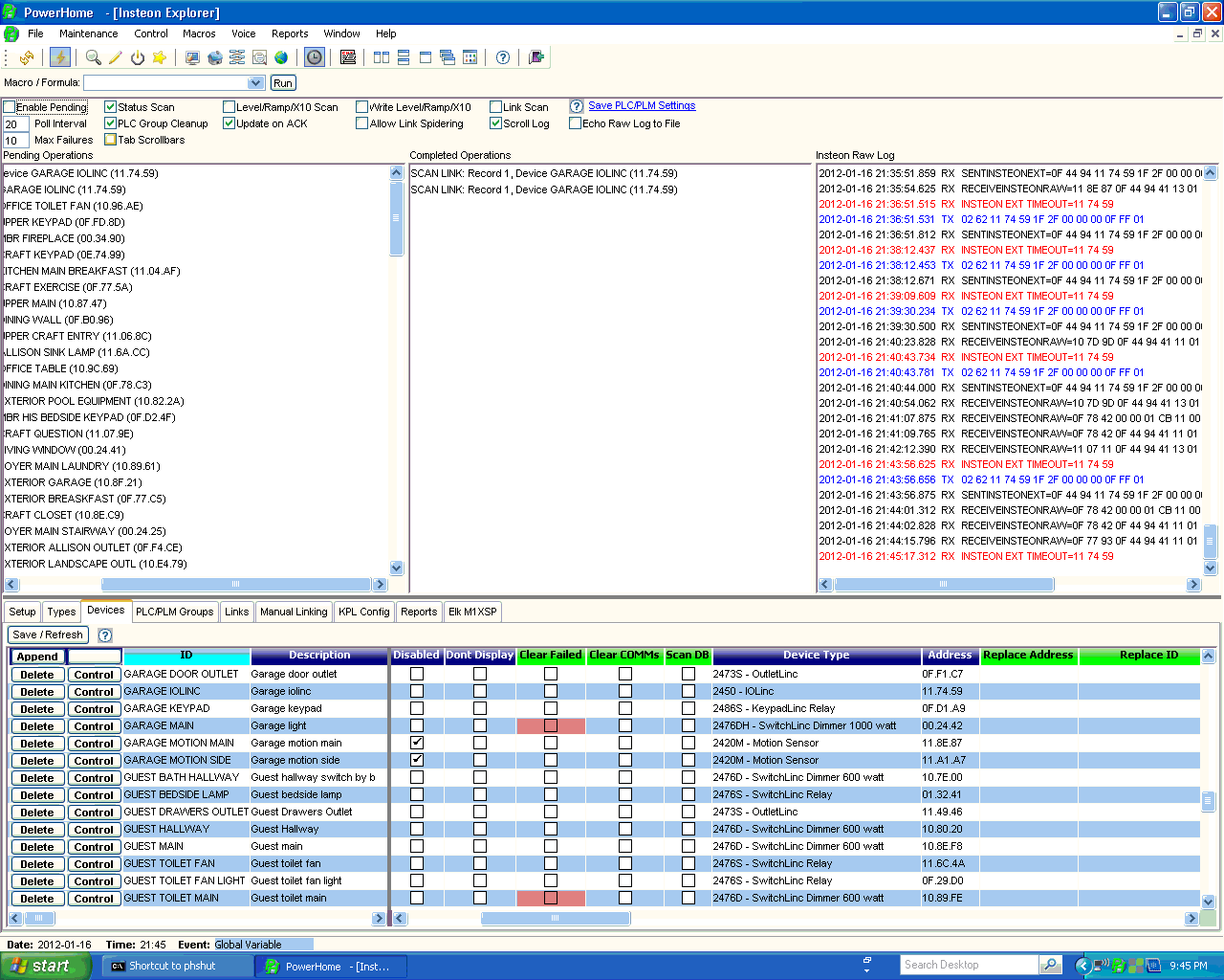

 Can you post some screenshots of your eventlog and Insteon Explorer documenting the Insteon timeouts.  A normal Insteon timeout shouldnt hang the GUI (could definitely hang the execution queue) so Im wondering if something else is going on that Im not expecting.
