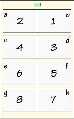

For the new RL2/Mini Remote the button Group numbers are
assigned as follows for the 8 button
button B = Group 1
button A = Group 2
button D = Group 3
button C = Group 4
etc
The 4 button Groups are A-D Groups 1-4

Here is an image of the button to Group assignments for the 8-scene remote (which as you point out are reversed from the normal RemoteLinc history) ...
