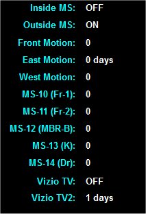

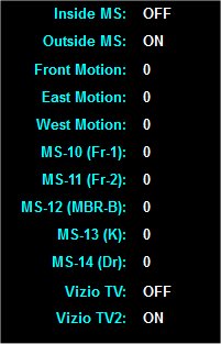

 2.  I do not fully understand how to use the  new WEB status variables.  Is there a trigger that happens when there is a WEB login/invalid login occurs that tells me to check those statuses?  It would not be efficient to just poll these variables repeatedly.  I'm looking for your guidance on how to make efficient use of these statuses.

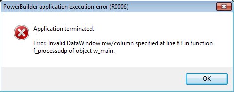

 4. The Remote-CC crashes, perhaps on a variable update. I checked all my coordinates, and none were out of range nor negative.  This did not happen in ver. 2,1.5a.

 2 and 3. The new web variables are in preparation for a trigger and eventlog entry. I wasnt able to add them in this release because it would require a database upgrade which would have pushed the release beyond Christmas. As a temporary measure, polling would be the only option. I'll get the trigger and eventlog added to the next version (2.1.6) along with the requisite database upgrade shortly after the new year.
 4. This is troubling. I checked the code and you are right. The error is in response to a global variable update. However, I cant see why it would happen. The RemoteCC is unchanged for version 2.1.5b as well as the UDP broadcast section of PowerHome. I use the remote CC in my own setup with Global variable updates and have not experienced an issue.
 Is it possible to review the eventlog to see what GV is causing the problem? Does it happen every GV update or just occasionally?
 The odd thing is that the error is an invalid row or column in the datawindow. The row should be good because line 82 references the same row without error. The column should be good (key_x) because its hardcoded into the datawindow and is used by every other object on the CC. Since its definitely a GV update causing the problem, any other info surrounding this that you can provide will help me get this solved quickly.

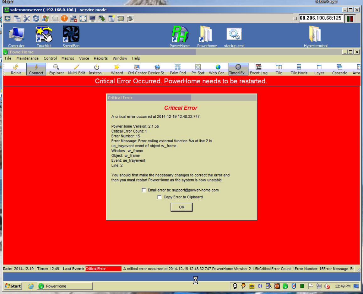

 I did notice that upon PH startup, my initial PH window was not full screen and the PH Explorer was only part "windowed" (I like to have it open and "full screened").
 So, I started to change a few settings in the pwrhome.ini file and ended up with this error (see image file).
 Any ideas on what to change in the .ini file for full screen Powerhome and full screen PH explorer?

 Not sure what could have caused that error. I'll take your INI file though and see if I can reproduce.
 You shouldnt have to edit your INI file directly though for these settings. From within PowerHome, just open the windows and position/size and set state the way you like. When you close PowerHome, it will automatically update the INI so that at next launch the windows will open in their previous state. Note: you can only have PowerHome remember to open a single window on startup. If you want to have multiple windows open on startup, you can use the ph_openphwin function in the startup trigger.
 Just to get you going, I would copy over your pwrhome.ini file from your renamed directory and launch PowerHome. It should startup without issue. Then just set the windows the way you like within PowerHome, close PowerHome, and reopen and see if they remember the state or not.
 I'll load up your INI file and see if I can pinpoint and fix the error to prevent it from happening in the future.

 I did copy over the prior .ini file ...I have not seen the error again (can't reproduce it).  After sizing the PH windows and then closing/exiting PH, upon the restart, the PH windows did not come back as desired.

 I might have some information about the remote-cc crashing.  I have been trying to narrow down anything that could identify anything. I'd chase something, and that would go nowhere, then I'd chase something else and that  would go nowhere.  Then all of a sudden I saw this on the remote-cc screen......(partial clip attached)
 The motion counts are numbers,
 and the Vizio TV is set to only "on" or off".
 it should be:
 Just after I saw this, the remote-cc crashed.  I ran the system again, and was able to re-capture this.  When I re-captured it, I immediately looked up the actual global vars, and they were correct.  The remote-CC had the wrong information. The CC has the correct information!
 Now, the data "1 days" is the first part of ph_windowsuptime()".  So, I looked at the macro that updates my global var of {stat_win_running}.  I set the global var {stat_win_runing} to mid(ph_windowsuptime(),1,(pos(ph_windowsuptime(),"sec"-4)).  The purpose of this is to drop the "seconds".
 So, I wrote only this one line in a test macro, and when I run this, it changes only the DISPLAY on the remote-cc global var {stat_vizio_tv2} from "on" to "1 days" while the actual global var remains "on".
 The "East side motion" global var {motion_east} gets changed when I run:
 set global var {motion_east} to  "mid(ph_powerhomeuptime(),1,(pos(ph_powerhomeuptime(),"sec") -4)). Again, to drop the "seconds".
 This is now repeatable, and I have no idea of why it's happening.
 Looks like maybe some kind of memory overrun, or bad programming on my part.  This might be related, might not.
 I'm going to keep looking, but this is what I've found so far.

           | Posted: December 19 2014 at 20:28 | IP Logged
Dave,
 I generated another instance of BeachBum's critical error, exactly same message but with a different fact pattern.  Conversion to 2.15b was uneventful.  After an hour or so a decided to address a previously identified linking problem with a Insteon-mediated 4-way switch linking structure.  Looking at the links for the switch controlling the actual circuit a noticed some '[ID Not Found]' lines in the links.  I have some in these my large database for some reason and they have never seemed to be a problem but I decided to remove them by dragging them to the the left.  2.15b immediately crashed with the error message noted above.  I repeated the process with a fresh copy of the program and database with the identical result.
 I went back to the 2.15a DB and program and tried to remove the [ID Not Found] lines and 2.15a removed them with no difficulty.  I went through the nearly 100 Insteon devices in my DB and removed every instance of [ID Not Found] and switched to 2.15b and it has been running without incident.
 As the DB is version compatible, I suggest users retain 2.15a for at least this type of database maintenance until this problem is figured out.  Otherwise 2.15b is terrific.  PH just gets better and better.
 Thanks Dave.

           | Posted: December 19 2014 at 20:50 | IP Logged
Steve,
 Ive tried to reproduce your critical error and have been unable to. Ive been using the INI file you attached with only a slight change to the database location and cannot reproduce the critical.
 However, I can reproduce the PH Explorer window not opening/staying at maximized. This is an error that got introduced as a result of a user requested mod to have the title of the window reflect the actual screen that is opened in the PH Explorer. It won't happen with any of the other windows, just the PH Explorer. It took me awhile to come up with a fix but I have it working now. There is an annoying flicker as you change detail windows within the Explorer and unfortunately, I cant get rid of it. The flicker is really only evident in the maximized mode but the desired operation of opening maximized (and staying that way) is now working.
 It'll be out in 2.1.5c (a bug fix to be released in the next few days).

           | Posted: December 19 2014 at 21:58 | IP Logged
gg,
 Started looking at your error with the Message Box macro command.
 Did some digging and the PH Explorer doesnt have any checking on ANY of its commands and instead either throws an error at runtime (such as the IR command fields being left blank) or just silently bypasses them (macro, x10, jump, etc). Due to the way the Explorer is constructed, it would be tricky to catch all of these types of errors at edit time so I would prefer to handle the message box problem at runtime as well.
 I can either make a popup message like the blank IR command or make it the same as other commands where nothing at all will happen. Just wondering if you had a preference.
 Thanks,
