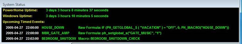

 Dave - thanks.  It's not a killer, when the timed event is a macro I see the macro execute in the log on the next line.  Unfortunately (and this may be bad coding on my part), some of my timed events look like
 if({VACATION}=1,ph_macroparm(blah,blah,blah...))
 and so if VACATION =0, all I get is that the event OS_XXX executed.  That's not horrible, since I can look up the event by event number (now, if it was possible to sort the Timed events screen by ID... ;-}), and since it was a null event, you could argue that it doesn't matter what it was.
 I'll muck with the fix you posted though. - thanks!
