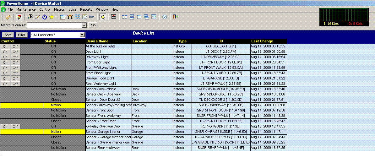

Screen shots attached. Help and comments appreciated.

Lots of great data but no specific question. The red shaded Motion Sensor entries are the result of not being able to communicate with the motion sensor. For battery operated devices, they must be in link mode before they will communicate to extend battery life. In the case of the motion sensors they do not support Peek/Poke commands so they cannot have the link database read or written even if in link mode. The TriggerLinc is also a battery device so the red shaded column may be because they were not put into link mode before PH tried to communicate with them. I do not know if a TriggerLinc supports Peek/Poke.
Since this may have nothing to do with your question, suggest you post your specific query.

I've tried the wizard and the manual link tab in Insteon explorer to add the "Sensor Garage Interior", and I can't see any difference in the configuration or the behavior of the devices. I've been seeing activity from each of the sensors already (see screen below), so I'm not sure what the problem is at this point. If PH see's the motion detectors going ON, why can't I create rules/macro's at this point?

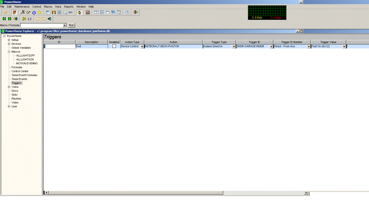

The following link will get you to a trigger definition for a motion sensor.
Link To Motion Sensor Trigger Definition
I would suggest the trigger action be the invocation of a Macro and issue the Insteon commands you want to happen from the Macro. There are potential problems with issuing Insteon commands directly from a Trigger that do not exist when issued from a Macro that is started from a Trigger.
| Posted: August 14 2009 at 12:46 | IP Logged
If you click on Control/Powerhome Status, you will get a display which has an Event Log toward the bottom of the display. If you trigger one of the motion sensors that has been linked correctly, you will see the Group commands the motion sensor is issuing for a motion detection. This information can be useful in defining a Trigger for an Insteon device you may not be familiar with regarding the type of Insteon commands being issued and the command codes involved. The only potential gotcha is that the Event Log is showing the cmd1 values in decimal (17 for an ON command) and the trigger value is showing the command value in hex (0x11 for ON command).

Pete, I think he did a successful "Manual Linking" tab operation because the Device Status screen capture shows the motion sensor ON. I could be wrong but I don't think it would show ON unless the PLM has taken the motion Group 1 message and passed it on to PowerHome. The only trigger definition that is posted as a screen capture specifies a Fast On command as the trigger value and that does not work because the motion sensor does not issue a Fast On.

Lee, I think they are linked and the trigger is set wrong but just to make sure I was looking for clarification. When I originally fought this problem it seems the device status screen showed motion detector on but the trigger won’t fire. Turned out it was partially linked cause I defined the links rather than let the device and PLM work it out. Sometimes the motion detector during setup has a mind of its own.

Manually added PLM to the motion sensor (twice) the the motion sensor activity is not being registered in Device Status. The set button will light up the Status screen, but motion is a bust. Feels like a step backwards.

“The set button will light up the Status screen, but motion is a bust.”
Pressing the Set button on the motion sensor causes it to send an ON command, then an OFF command, and so on. If the motion sensor Set button causes the Device Status screen to change, then the link was successful. If motion itself is not changing the Device Status screen, then you look at the motion sensor itself. There is timing interval on the motion signal. Once it sends a motion signal, further motion does not result in another motion signal. Only after all motion has stopped for a certain amount of time (documented in the motion sensor reference material) the motion sensor sends an OFF command. Until it sends the OFF command, no further ON commands (motion detected) are sent. That is all motion sensor hardware. It has nothing to do with PowerHome.

John, going back to your earlier post, if your trigger is still the same try this. Trigger Type - Insteon Group In, Trigger ID Number – 1, Trigger Value – On(0x11).
