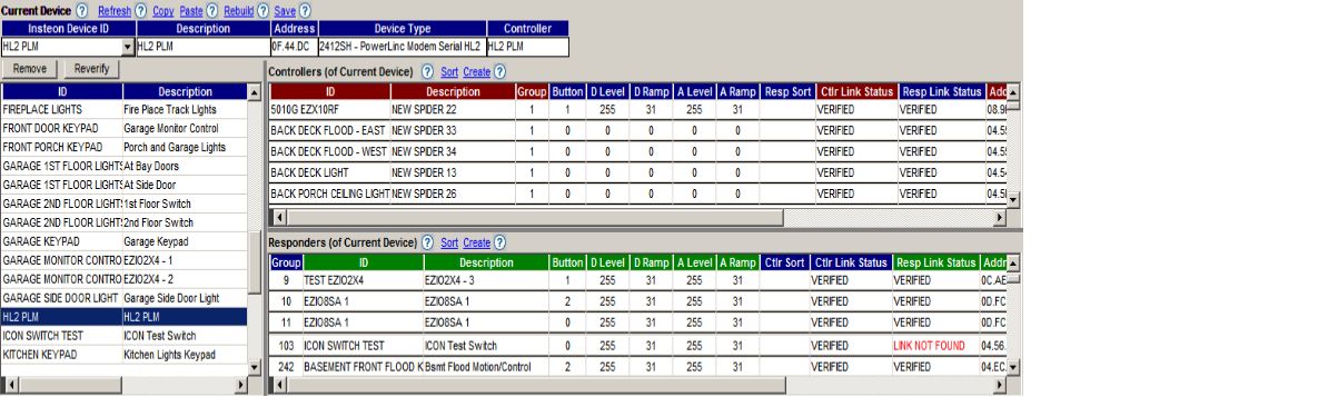

| Posted: October 26 2009 at 19:29 | IP Logged
All the devices that are linked as responders to PLC/PLM Groups are listed in the Responders section of the PLM device, clustered together by PLC/PLM Group number.
The Responder devices under Group 9,10,11 are PLC/PLM Group devices.
