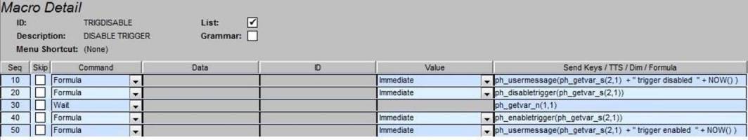

Joined: April 11 2007 Location: United States
| Posted: November 26 2009 at 13:20 | IP Logged
The following is how I eliminate the double firing:
